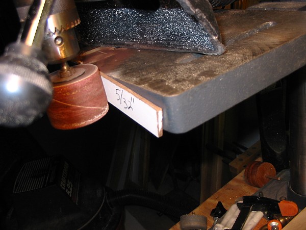

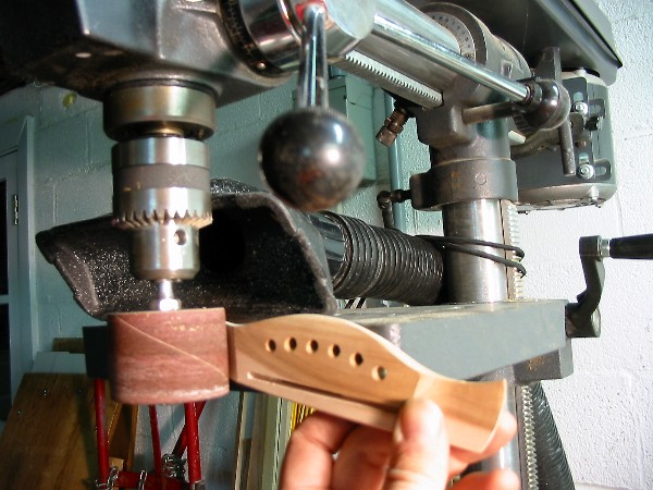

Today I was planning to make some bridges. Thinking through setting up fences, clamps, stops, and ramps for my combo sander or drill press to get it done, or buying a specialty fixture. Not happy with any of these ideas.
This is the revelation I got, and it works great. Set the spacer in for wing thickness first (about 5/32") I just make a line parallel to the bridge wing tips, and eyeball as I sand.
Till I have time to make a fancier jig than this, I'm a happy camper!
PS - having a radial arm drill press helped make this trick happen.

Nice idea. Now you need to find a way to keep that angle steady and repeatable for both sides.

Good looking bridge, what kind of wood is that?

[QUOTE=Brock Poling]
Looks like Hickory...

Hey guys, don't go lusting after my Poplar stash... It's a Poplar prototype. I thought the contrast would work better than an ebony one.

Heh. Rockin'. I may just have to steal that idea, instead of constructing elaborate, complicated jury-rigged systems to do the exact same thing. Thanks!
